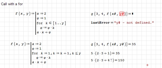

#3 Опубликовано: 18.11.2020 16:47:05
... and issues in composite functions with loops.

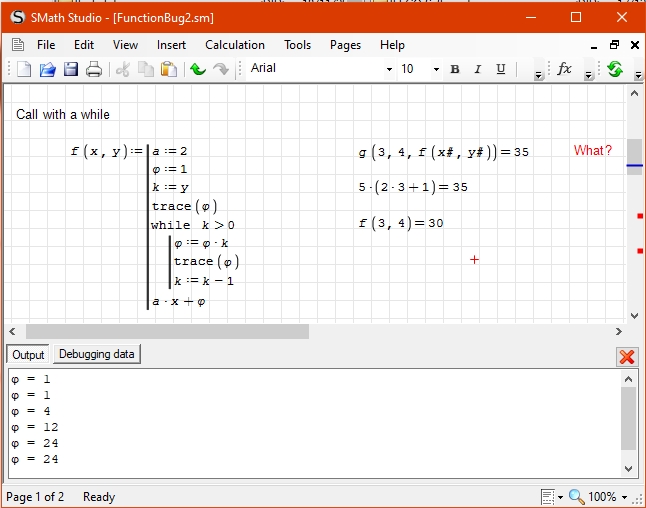

Debugging with trace(), what I see is that when calling g, f takes phi=1, (this is the first phi=1 in the output window) but don't do the loop. Calling f isolated shows another phi=1 and subsequent values for phi.
With for(3) gives an error, so I can't debug that. Additionally, calling with for(4) seems to have the same behavior than while.
