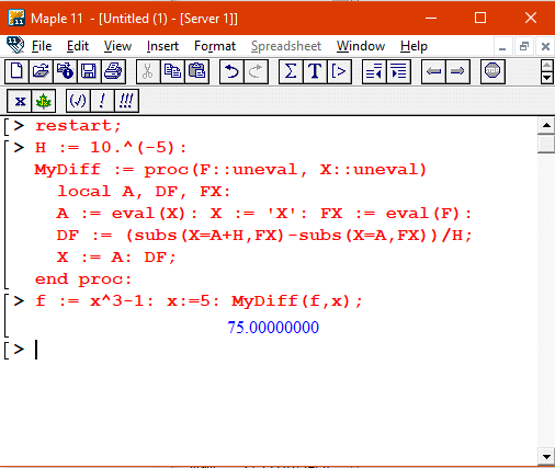

Hi.
An uneval ability, like 'x' and x::uneval in maple, or Mathematica's Hold .
Thanks for this wonderful tool that is SMath.

Sure, I'm requesting them.
You could also use the method Jean suggests, by calling ...
Jean's method is close, but not enough (actually it's equivalent to x='x' in the image). Can you replicate this Maple's code in SMath?
