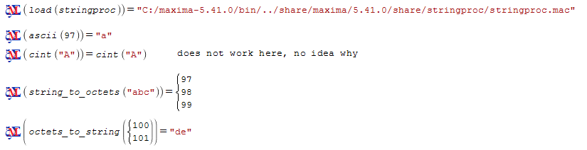

#3 Опубликовано: 17.06.2018 17:34:52
There are some conversion functions in Maxima.
ascii.sm (4,27 КиБ) скачан 1235 раз(а).

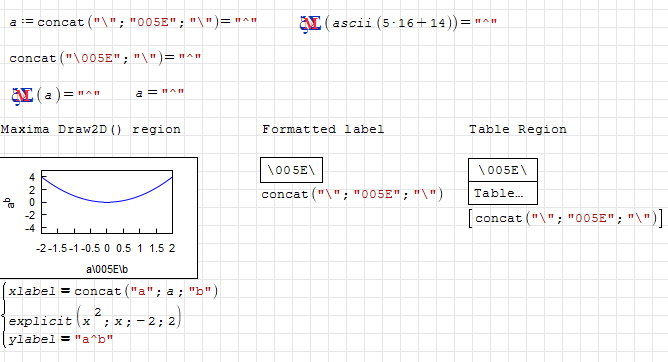

#6 Опубликовано: 18.06.2018 11:42:50
Hello.
Another example is available here: https://en.smath.info/forum/yaf_postsm47084_SMath-Studio-0-99-6617--12-February-2018.aspx#post47084

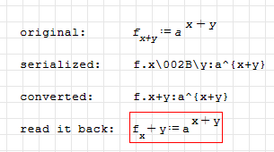

There seems to be something special with the characters generated this way. They will be backconverted to code sequence if used in Maxima region, label region or table region.
Zeichenketten.sm (57,75 КиБ) скачан 1164 раз(а).
#7 Опубликовано: 18.06.2018 12:25:29
Now I know why cint("A" ) does not work. It is a translation problem from SMath to Maxima, see SS-3543.
#8 Опубликовано: 18.06.2018 12:29:10
They are special indeed, you can see it by exposing the plain text with copy/paste... The syntax is handled at code level by the math region (like a bbcode or a markdown text)

#10 Опубликовано: 18.06.2018 14:06:19
But why need they to be stored this way? SMath can store and display the corresponding symbols directly.
Because many characters are taken by the math syntax... +-*/.,:;<>(){}@#! (and many more)... converting the code in character may cause trouble while reading back the code.
