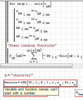

there are known issues with the iterator name of functions like sum, if that variable was previously defined; just clear it before using inside sum.

Alternatively I could have used a different variable name?
You can, but you might experience the issue again if that variable is used somewhere and then you call your function

Clear() is the most reliable way to act, and won't change the logic of your function even when this issue will be solved

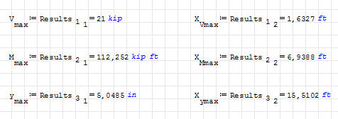

1. I seem to get a bad result (it is incorrect) as noticed by the units. I'm not sure what's going on there.
2. Where is 'n' being defined in the original function? Or do I need to clear(n) before every sum?

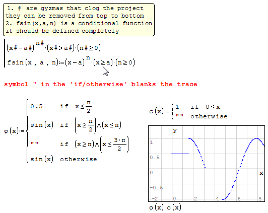

There is no error message... what about changing the exponent 'n' in fsin(x,a,n)
with something less confusing. Whether your version needs 'Sum' be locally defined
or not ? ... you must try the example posted before.
Clear(n) does nothing. To clear 'x' in a project, instruct like this
x:=Clear(x) ... don't know if it clears within program ?

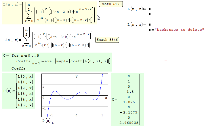

If you want to clean from the gyzmas '#': easy and not easy
Put the selection on the right of a#, press F8 to select all [highlighted gray]
Press backspace to remove the # ... it does not clean an exponent and may not
clean a long construction. Check each has been cleaned, if not clean manually.
[Old work sheet that now produces error]
That's what you have to isolate first, it was created 5346 or earlier version.
If so => the suspect is the Sum(s). Personally, I have dozens of those.

WroteThanks for you help. A couple questions:
Not really sure what's going on there while the units are correct, but they shows that something is messed up. What is going different is that nested systems are no more joined (at least for the el() function).
You can use a couple of nested el(), that however are correct for how the result is built (a system of systems)

Please, check the attached:
1. Not a case of clearing anything
2. Changed the nSum for mSum
3. Removed all gyzmas #
4. NO error message
I understand nothing in that kind of work,
but results make sense even with units.

Do you have the right results ? That was the question.
If NOT, you may have to debug the program piecewise.
Cheers, Jean
WroteYes, i do, thank you.
Nice you have the right result c/w units.
