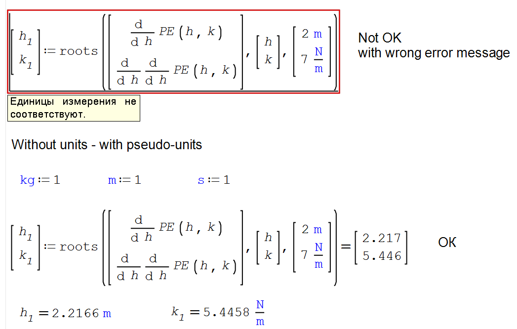

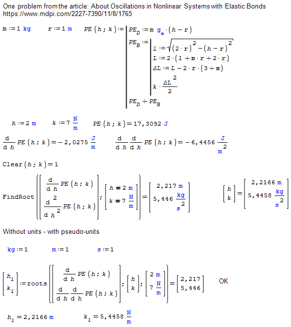

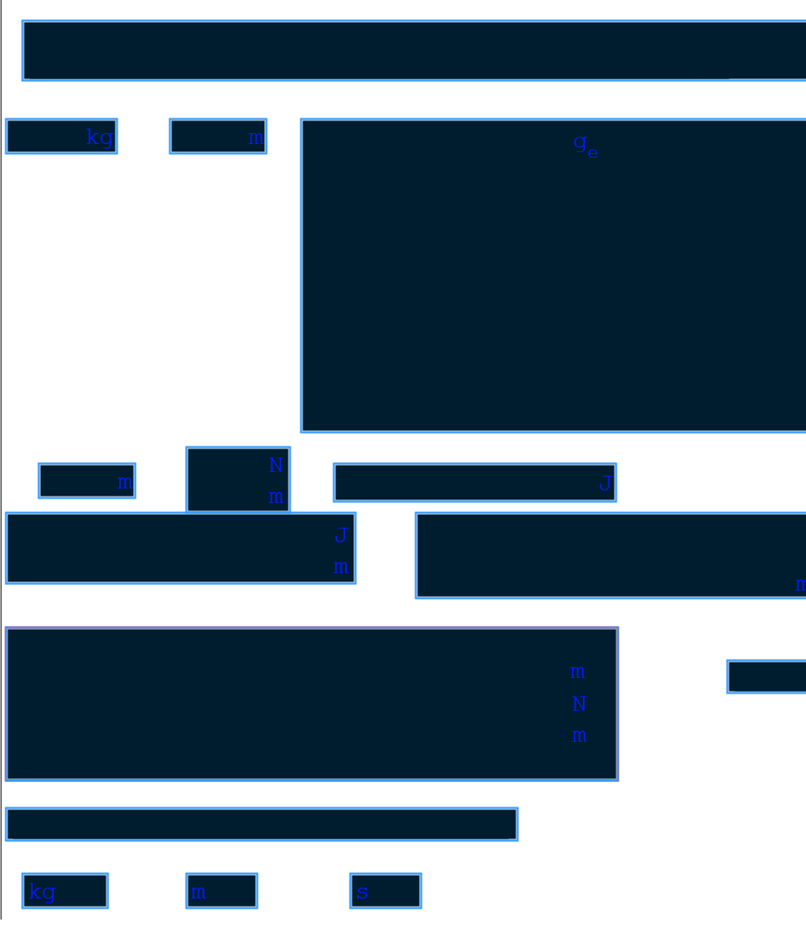

Can Roots and Solve functions work with units?
See please the attach!2-4-OOO-Plots-DD.sm (14,94 КиБ) скачан 1424 раз(а).

WroteCan Roots and Solve functions work with units?

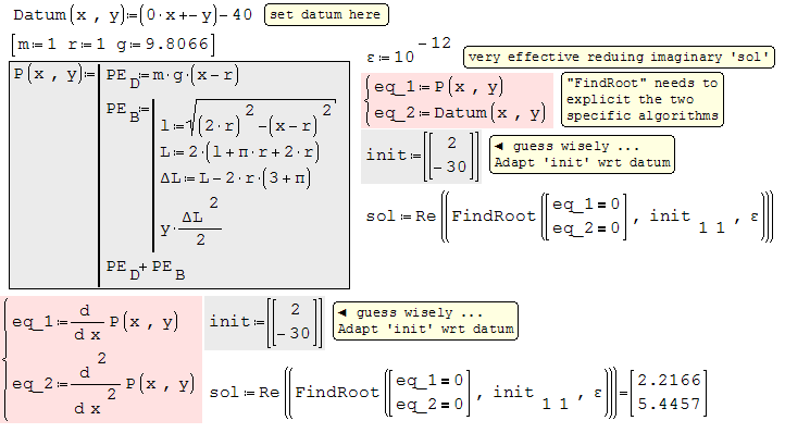

There are several ways to handle units with SMath roots. This is one of them, where the units are sterilized (Pompelmo' dixit) locally, instead of globally.
2-4-OOO-Plots-DD.sm (12,96 КиБ) скачан 1385 раз(а).

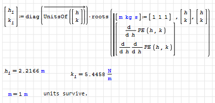

WroteWroteCan Roots and Solve functions work with units?
Thank you, but this is very difficult for me.
The question was simple: Roots & Units.

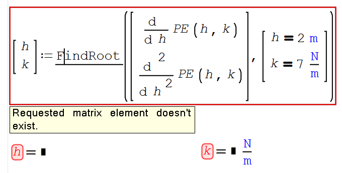

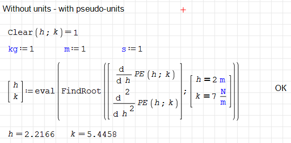

It is simple, if you use Findroot()
2-4-OOO-Plots-DD_Kr.sm (16,37 КиБ) скачан 1386 раз(а).
