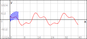

Attempting to transfer a worksheet from MC Prime to SMATH. Couldn't get page 3 of my SMATH sheet to augment the x & y data for the graph; I tried a few variations , yet unsuccessful. I welcome any input(s)/recommendation(s).

Here's the updated worksheet.
Review of System Transients.sm (197,75 КиБ) скачан 1190 раз(а).
The graphs differ some from the MC version, also some added data/lines in the graphs are exhibited.
Thanks again Alvaro. Your experience with SMath is indispensable!

Ah-h! I tweaked the 1st line under the "for" loop and the graphs are better.
Something like this ?
Review of System Transients (2).sm (280,61 КиБ) скачан 1207 раз(а).
#7 Опубликовано: 19.01.2023 14:38:46
Hi Norm. This version returns the same plots. Initials conditions in yellow.
Review of System Transients.sm (233,04 КиБ) скачан 1225 раз(а).
