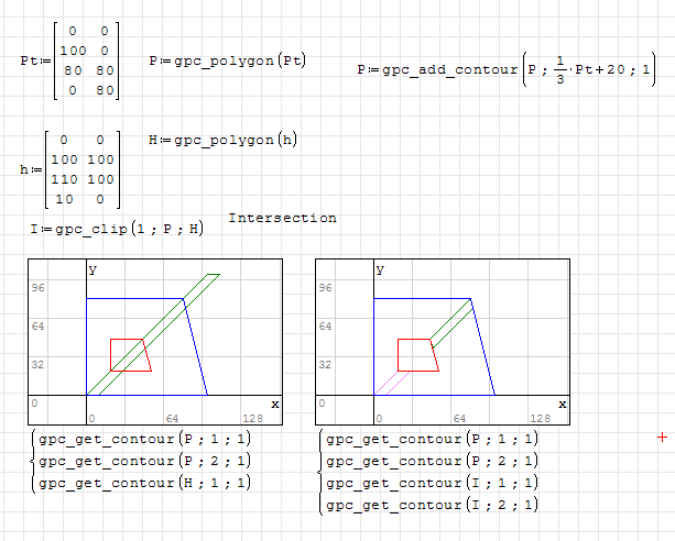

In regards to hatch and fill - do we have a Smath code that can hatch a closed polygon?
Try the gpc wrapper plugin by davide
GPC.sm (6,8 КиБ) скачан 1866 раз(а).
