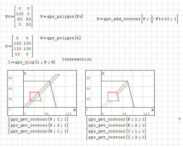

In regards to hatch and fill - do we have a Smath code that can hatch a closed polygon?
this might help?
We don't have it yet for the closed polygon.
Try the gpc wrapper plugin by davide
GPC.sm (6,8 КиБ) скачан 1548 раз(а).
