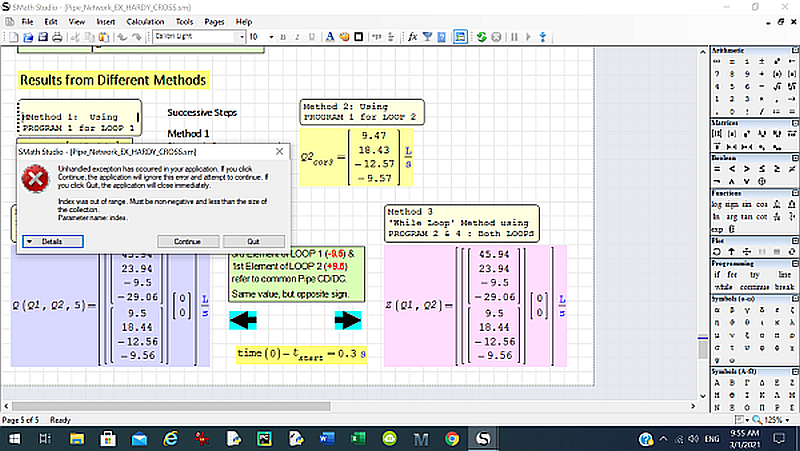

Whenever I try to edit contents of some description boxes the unhandled exception error message props up. For information of Developers please.
#8 Опубликовано: 01.03.2021 07:41:53
Please attache the content of the "Details" window.
Details Window.txt (30,14 КиБ) скачан 1254 раз(а).
Pipe_Network_EX_HARDY_CROSS.sm (299,12 КиБ) скачан 1549 раз(а).
#10 Опубликовано: 04.03.2021 08:53:47
Группа: Super Administrator
Both issues fixed. Thank you!
