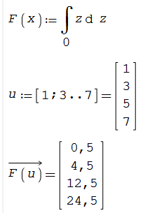

#2 Опубликовано: 30.01.2021 11:41:19
in Smath you have to use explicit vectorization

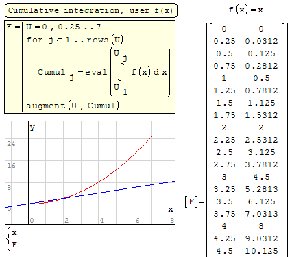

#5 Опубликовано: 30.01.2021 23:09:00
... hyperfast.

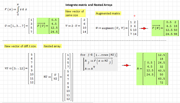

#6 Опубликовано: 31.01.2021 03:09:04
NDTM Amarasekera
NDTM Amarasekera
Integration values extended to matrix and nested arrays.
