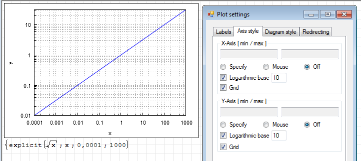

loglog and semilog plots can be created with Maxima Draw.
Insert> Maxima> Maxima Draw2D
Then you can specify graphics objects. There is partial support for the settings in the context menu. These settings also can be specified in the graphics command list.
An example with log plot can be found here
loglog.sm (17,73 КиБ) скачан 1518 раз(а).

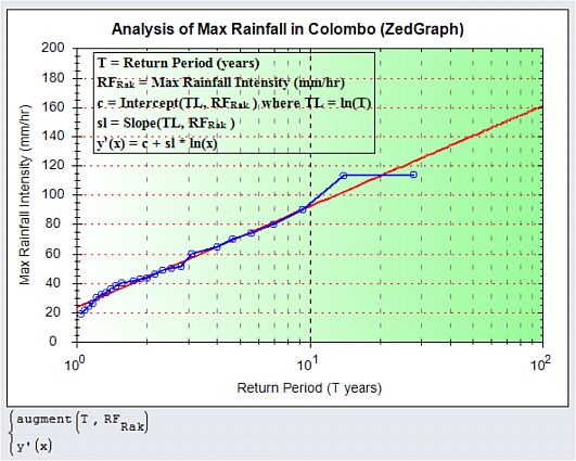

I don't catch "ndtma" plot, it looks to me a "qq plot".
This type of plot is on linear/linear. log scale is a
means to visualise globally large range of values.
You could probably manage your demand inspired from
the "logpts" attached.
Utilities logpts.sm (42,29 КиБ) скачан 1370 раз(а).
