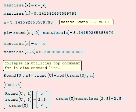

How can I enter a value to display the integer and fractional part
... make it algo style utility.
