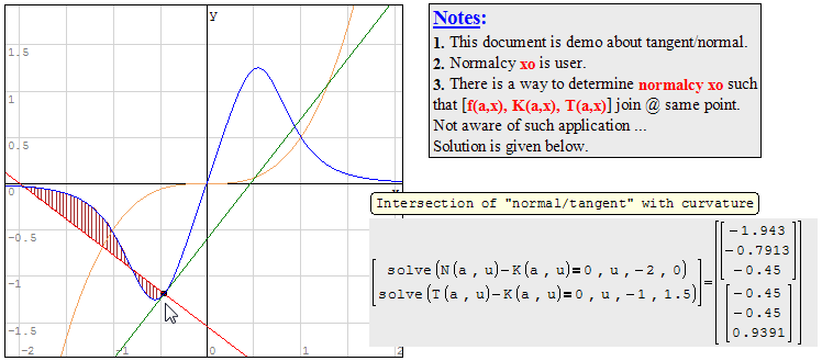

#1 Опубликовано: 15.09.2017 10:17:00
Maths Tangent.sm (24,15 КиБ) скачан 1317 раз(а).

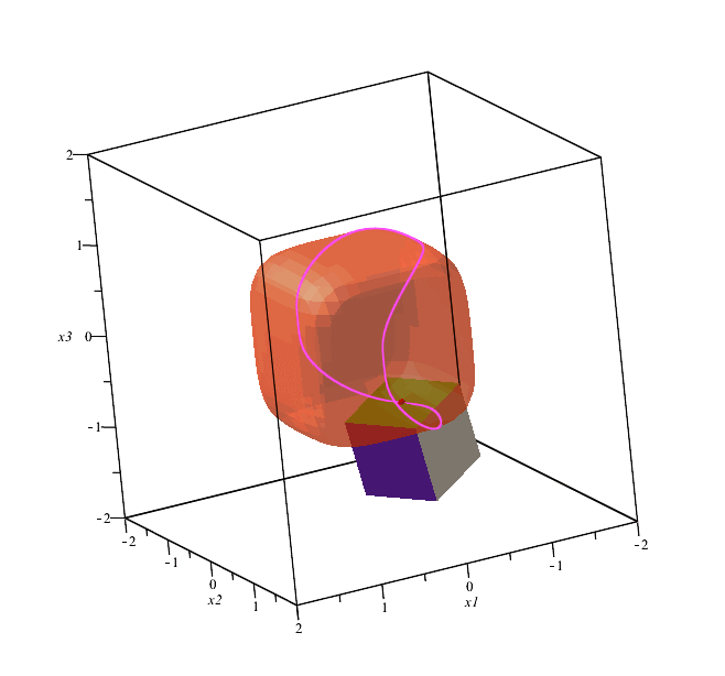

From Maple.
One face of the cube belongs to the tangent plane to the surface at each point of the curve.
http://www.mapleprimes.com/posts/208425-Tangent-Plane-As-The-Square-At-Any-Point-Of-A-Smooth-Surface-#comment202577
