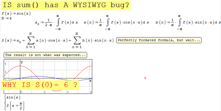

I was writing an example of Fourier series when I encounter a misleading display with the sum() function. Here is the setup:
![2019-05-09 11_30_56-SMath Studio - [ISERROR QUESTION MARK_B.sm_].png](/ru-RU/files/Download/qze7hq/2019-05-09-11_30_56-SMath-Studio---[ISERROR-QUESTION-MARK_B.sm_].png)
Look at the attached file for full setup and findings.
ISERROR QUESTION MARK_B.sm (17,61 КиБ) скачан 1233 раз(а).
I understand the case, and I don't have a solution for that. I just wanted others to save time finding what is happening here.
One way I discovered this behavior was by trying to select only the right part of the formula, the action always selected this part:

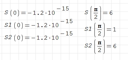

S(0)≡S1(0)≡S2(0)≡0 ... No error wrt the 3 different constructions.
Try save under another name, close PC, open new session.
As you report it looks there is shadow in the construction context.

It's a quite common problem. One solution software-side is to add automated parenthesis (and we are able to do it, look for example at booleans); enforcing this approach however has as drawback that in quite simple math you might end to have an huge amount of useless or unwanted parenthesis due to the interaction of enforced rules to different operators and functions. It's something quite delicate to handle; don't force them leave the doors open to some mistake, but even the choice to the user to handle them.
