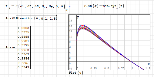

See attached sm file.
I am trying to find the k values of alpha that are roots of the system of k transcendental equations. I don't understand the required syntax.
I have the equivalent MATHCAD 15 file if that is helpful to anyone.
Thanks for all help.
Reg
LITTLE BOY LAMBDA AND ALPHA.sm (86,48 КиБ) скачан 1593 раз(а).
Reg CurryLoveland, CO

Hi Reg. You can try this.
LITTLE BOY LAMBDA AND ALPHA.sm (93,57 КиБ) скачан 1655 раз(а).

Alvaro,
Thanks. I will give that a try. I found a couple of typos in my definition of the elements of F. But, I will fix that and try your method.
I got a little further using the solve function; however, I am having trouble getting it to plot.
LITTLE BOY LAMBDA AND ALPHA.sm (63,61 КиБ) скачан 1612 раз(а).
Thanks again,
Reg
