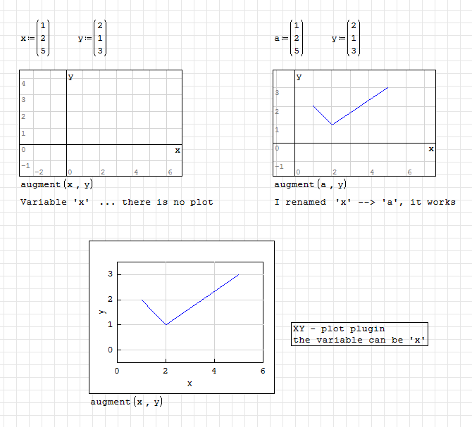

Hello.
It is not possible to plot an augment function with 'x' as parametr.
Is it a bug, or some special feature of 'x'?
regards Olik

This is not a bug. In the 2D plot region x and t are special unknowns (abscissa and animation parameter); both are parsed as local variables (doesn't matter if there are these variables on the canvas as defined values - except for t that can be used if you don't animate the plot). Therefore when you write augment(x,y) you are trying to augment each x displayed in the plot with y.
Obviously you can define the input matrix before the plot, outside the region placeholder; in this case x and y are parsed outside the plot and the input is simply the 3x2 matrix.
The X-Y plot works differently.
olik 27.11.2015 12:39:00
Thanks.
Are there SMath other special unknowns? Or functions with special unknowns?
I think - for example - 'x' in integration ( int(T(x),ξ,0,x) ).
Regards Olik

In general, only lastError [this variable will be overwritten by any function giving an error.] and maybe i (there should be a post by Martin Kraska somewhere about issues noticed using i in some special case) and e.
