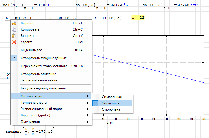

See please the attach.
n<=21 - all OK!
n>21 - not OK
Why?
TubeMChS.sm (66,92 КиБ) скачан 1150 раз(а).

Указать численную оптимизацию.
Спасибо!
И много таких подводных камней в SMath?

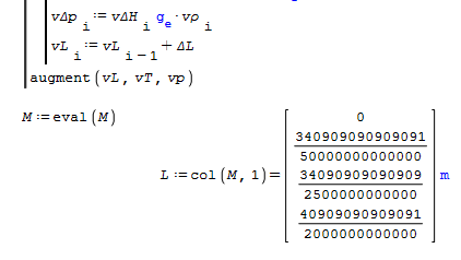

... И много таких подводных камней в SMath?
Hi. That's not SMath pitfalls. It's a feature: SMath remembers the intermediate steps of what it's calculating, unless you tell it to forget them, with eval. This also usually speeds up the following steps.
