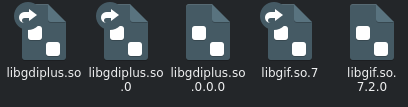

This happens because libgdiplus in appimage has missing symlinks.
I added and recompiled appimage with libgdiplus symlinks added.
Now it works. I don't know why Andrev didn't add those links, who knows?
Download appimage linked below, I have tried with linuxmint_22 live iso.

I did extract content of original smath appimage from terminal via --appimage-extract argument.
Added libgif.so and symlinks for libgdiplus.
Mono library replacement shouldn't be necessary, only for just in case.
Andrey, you can take my appimage and extract its content.
Only smath file updates should be enough for new appimage creation.

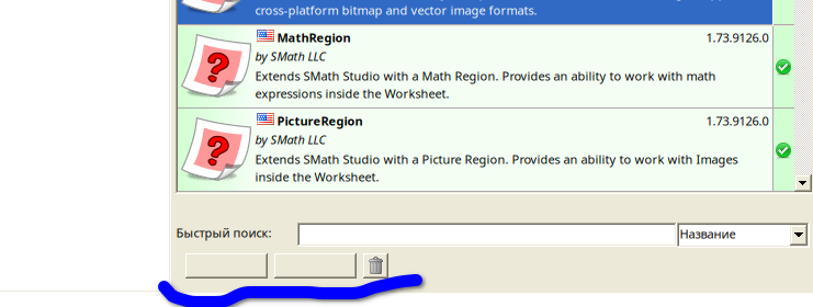

#17 Опубликовано: 28.12.2024 01:56:55
TopUser2000
TopUser2000
0 сообщений из 28 понравились пользователям.
This should work now, please check it and report
it works even with XYplot plugin)
But some text can't be imaged like in the previous version
#18 Опубликовано: 28.12.2024 02:15:50
This version even works with ubuntu-24.04 along linuxmint-22.
I only added export MONO_WINFORMS_XIM_STYLE=disabled before exec mono.
It prevents a stupid mono bug keeping applications crash at start.
Change is applied to smath_launcher in appimage.
For the lacking of button texts, it is probably mono error.
Possibly I can't do anything about that.
SMathStudioDesktop.1_3_0_9126.Mono.x86_64.linuxmint-22.glibc2.35.AppImage.tar.gz (11,7 МиБ) скачан 1157 раз(а).
