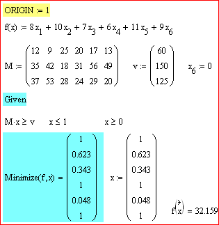

Minimize/Maximize - Is there in SMath some tools (plugin) as Given...Minimize/Maximize in Mathcad? - Сообщения
Greetings,
The Plugin is called 「Custom Functions」 by Davide Carpi; there you have Min() and Max() as they behave in Mathcad.

you might check here: https://en.smath.com/forum/yaf_postst20261_function-maximize-minimize--in-Smath-Studio.aspx
From Smath Forum.

Hi. Also you can see Lagrange multipliers with Draghilev's method and Mathcad solve blocks here: https://en.smath.com/forum/yaf_postsm80940_Mathcad-Toolbox.aspx#post80940
