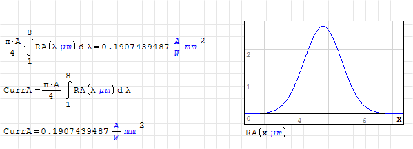

Thank you very much for your answer,
I've attached a file that's explaining the error that I get.
resource1.sm (13,04 КиБ) скачан 1136 раз(а).
Good point:
If your function involves units you must specify units on the independent variables when calling the function.

I wanted to assign units to the result taking into account the geometrical interpretation of line integral, similarly Callmeishmael referred to units for the physical meaning of velocity.

Davide Carpi 09.01.2013 08:44:00
Thank you very much for your suggestions: now the formula is working correctly.

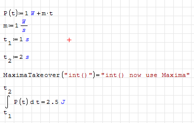

I don't understand. If you have a constant power dissipation of 1 W for 1 second, you will consume 1 J of energy. To write this in integral form: [see attached image]
int(1 W, dt, 1 sec, 2 sec) should equal 1 W * (2 sec - 1 sec) = 1 J
So why can't we use units in the limits of the integral?

So you're basically removing the units before the integral and then re-adding them after it's done? What does LE stand for and why is it blue like a unit for you? It's not for me.
..assuming you have the Maxima plugin installed and Maxima installed?
