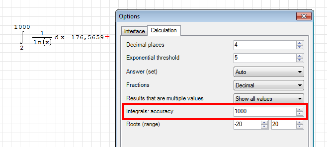

The integral of 1/(ln(x) with limits of x from 2 to 1000 does not agree with mathlab or maxima --
The numerical value of the following integration is off -- should be 176.56 and Smath gives 177.1
Any idea what could be the problem?

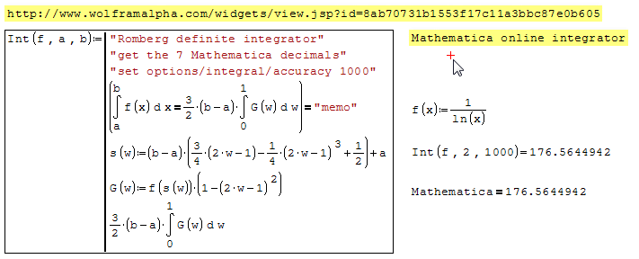

WroteAny idea what could be the problem?
Smath Simpson iterative integrator is known to range from
exact [sometimes] to poor. Increasing accuracy is fine in
this example but will not converge in other instances like
in the Fourier Quantum double integral. You can rescue
your example using the attached Romberg.
Mathematica online integrator link added.
Integrate Mathematica.sm (9,92 КиБ) скачан 1295 раз(а).
... revisit same work sheet for the 7 decimals !
Integrate Mathematica.sm (10,19 КиБ) скачан 1264 раз(а).
