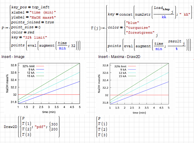

I am using XY plot to generate multiple graphs, however I am doing it manually. How can I
1] Script a loop to dynamically generate multiple plots
2] Dynamically generate series name (which will be used for plot legend)

If Maxima is an option for you, then you can entirely automate the production of plots.
For an overview on available plot objects and options see SMath with Maxima.
In X-Y Plot, you can use geometric objects to create the lines and perhaps also a legend.
BTW, there is no point of naming the variable Load.kAmp, because the value is converted to A anyways directly upon storage, unless you just store a number, bypassing the SMath unit system. When you retrieve numerical values, you decide what units to use, independently of what was originally used to specify the value.
![2024-12-15 17_20_47-SMath Solver - [NaOH_Demiwater_VECTOR_Kr.sm].png](/ru-RU/files/Download/Hn75yo/2024-12-15-17_20_47-SMath-Solver---[NaOH_Demiwater_VECTOR_Kr.sm].png)
NaOH_Demiwater_VECTOR_Kr.sm (208,46 КиБ) скачан 1788 раз(а).
