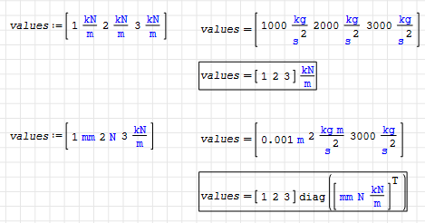

#8 Опубликовано: 12.06.2023 05:29:17
1 430 сообщений из 2 889 понравились пользователям.
You have to customize the result units in the rightmost placeholder.
sergio 12.06.2023 05:44:00
#9 Опубликовано: 12.06.2023 07:01:46
AR
AR
Thank you! I don't know how I didn't get that working couple days ago, I tried to write units outside of brackets but didn't succeed. But now it works no problem
