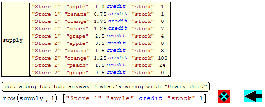

#1 Опубликовано: 06.03.2018 11:15:32
No logic in that observation.
How can I explain if I can't explain to myself ?
Utilities Matrix [Parse Lookup, Truth Table].sm (26,37 КиБ) скачан 790 раз(а).

#3 Опубликовано: 06.03.2018 13:47:03
1 440 сообщений из 2 927 понравились пользователям.
The 1 in results with units was suppressed in SMath Studio 0.98.5935 (there is even a comment by Mike in that thread about this behavior) and doesn't apply anymore at least since the version 0.98.6606 (talking just about stable versions)
right now I cannot find if this was fixed intentionally or not, however it seems is no more an issue currently
2018-03-06 17_42_20-SMath Studio 0.98.6606 - [Utilities%20Matrix%20[Parse%20Lookup,%20Truth%20Table].png

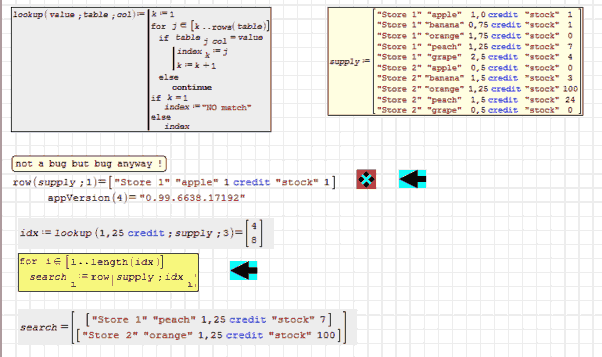

#4 Опубликовано: 06.03.2018 13:54:40
CBG
CBG
Hello Jean
The version "0.99.6638.17192" of Smath Studio does it correctly.
I also propose a small change in the variable "Search"
#5 Опубликовано: 06.03.2018 22:39:33
Thanks Crlos,
Your'e right: just search for what is demanded.
