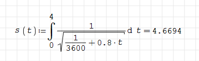

When trying to solve the following definite integral using Smath, the result returned by Smath is incorrect. Can somebody help me, please?
int(1/sqrt((1/3600)+(0.8*t)),t,0,4)

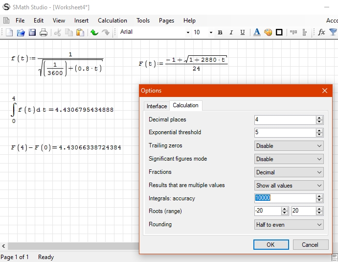

#2 Опубликовано: 22.04.2021 01:00:20
Hi. It's a numeric issue of the numerical procedure for integration. Try to change "Integral accuracy" option ... from 100 to 10000. Ok, that make it very slow.

#3 Опубликовано: 22.04.2021 01:50:45
Victor
Victor
Chau.
It works! Thank you very much, Alvaro! Regards!

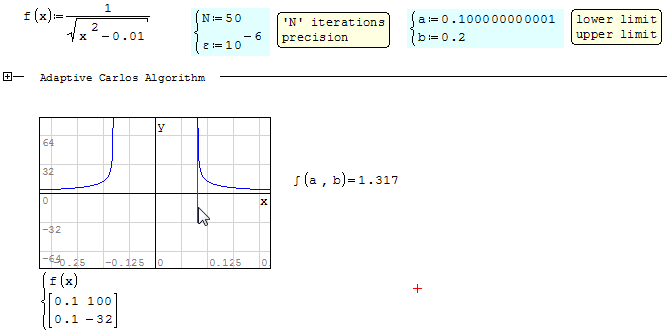

#4 Опубликовано: 22.04.2021 08:34:00
1. Always plot the integrand
2. Try Wolfram Alpha
3. Use Smath Carlos ... hyperfast/accurate
Page17 Integrate Carlos.sm (84,63 КиБ) скачан 1717 раз(а).

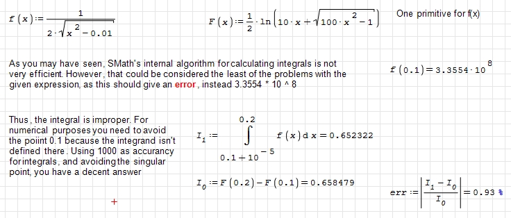

I have the same problem again with this definite integral. I have tried to change the "Integral accuracy" but it hasn't worked. Can you help me please? Thank you.

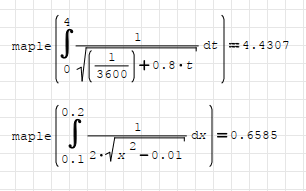

int(1/(2*sqrt(x^2-0.01)),x,0.1,0.2)
Try to use maple or maxima plugin.

#9 Опубликовано: 22.04.2021 23:11:13
Hi. The problem with your example, now, isn't the bad integration, it's that it give you a number, not a an error. Notice that the integrand isn't continue at x = 0.1, it's undefined or infinity, because you divide by zero there.
As Overlord points, you can use Maple or Maxima for handle this kind of problems.
ImproperIntegral.sm (9,46 КиБ) скачан 1415 раз(а).

#11 Опубликовано: 23.04.2021 10:08:48
Page17 Integrate Carlos.sm (88,08 КиБ) скачан 1651 раз(а).
In some instances, Adaptive is of no profit, but not detrimental.
