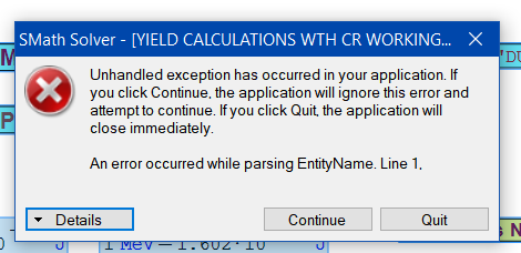

I periodically get this error pop up. I'm never quite sure what caused it because it happens with multiple SMATH files.
If I click on continue, things seem to progress as normal giving the correct answer.
Is there any guidance on the various conditions that cause this? The text is not always the same. If I click on Details, I'm not smart enough to understand the diagnosis. I don't recall it happening before I recently updated SMATH to SMATH Solver.

Hard to say without knowing the latest actions and the context. Next time it happens please copy the stack trace provided in the details window.
Sometimes deleting the %appdata%/SMath directory helps, because some plugin might have some hidden trouble with your current SMath Studio API. (You can rename the SMath folder to keep it and restore the data deleting the new SMath directory if nothing changes - see here).

Thanks. I will copy the stack trace next time and provide that.
