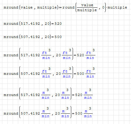

I would like to have the answer "round" to the nearest XXX. In this example, I would like an answer that gives 520 and another that gives 500
I do not want to truncate to get the 500 as I may get 589 and would like to round up
Apparently, units are part of the problem
#2 Опубликовано: 28.04.2016 15:38:05
1 430 сообщений из 2 888 понравились пользователям.
Something like this?
ElSid 28.04.2016 15:48:00, frapuano 28.04.2016 17:24:00

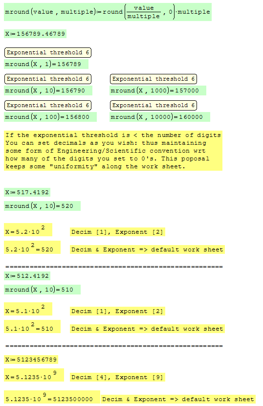

#8 Опубликовано: 29.04.2016 10:41:13
