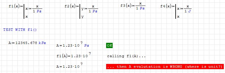

someone can confirm this issue?
seem that:
- it's not related with optimization
- appears only when you redefine an internal variable inside a line() in a user-function, making them dimensionless
best regards,
w3b5urf3r

This is related to changing the function arguments. As your function is defined as f1(x) and you actually change x then if you call your function with f1(A) then A will change as well. Your function f4(x) actually changed its argument too.
WroteHello w3b5urf3r,
Hi Omorr
you're right, f4(x) cause the same issue...
I don't know if it's a bug or a feature, but it's quite strange for me... In my mind I think that
the input variable should not be modified, unless the change it's invoked directly (A:=something)
best regards,
w3b5urf3r
Yes, this is by design. This feature called Output Arguments and it can be used within procedures (functions defined with line(..) at right). This allows to return any number of values from the function. One just should remember that changing value for the variable of the same name as defined in function's arguments for such functions will also override global value of that variable.
