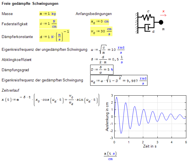

In the online gallery under Handbooks, there is a new 35 page German tutorial. It is designed along a simple engineering example and covers these topics
- Installation, activation and settings
- Text and formula regions
- Variables and functions
- Units
- Results formatting
- 2D plotting
- Editable embedded images
- Export to PDF
- Access to the Interactive Handbook
- Posting to the forum
- Further reading

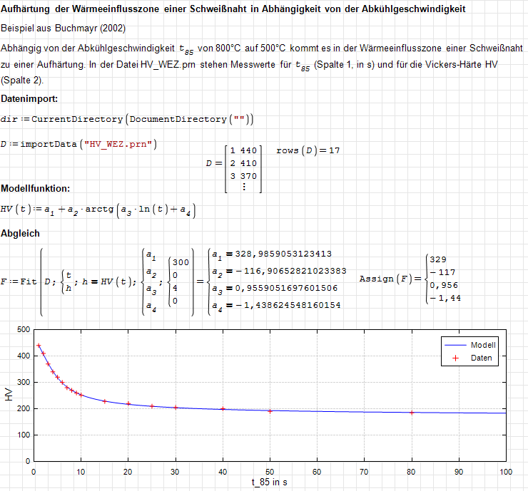

New document available in the online gallery:
German Handbook with focus on data handling
- Matrices and vectors (does not cover linear systems and algebra in cartesian coordinates)
- data import
- Plotting with X-Y Plot Region
- Tables
- Linear and non-linear regression
I hope you like the style with single-page sections and chapterwise tables of contents.

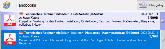

Unfortunately, when I try to download the two current manuals "Technical Calculation ..." via the plug-in administration, the message "BadRequest" always appears.
#4 Опубликовано: 2 года назад
WroteUnfortunately, when I try to download the two current manuals "Technical Calculation ..." via the plug-in administration, the message "BadRequest" always appears.
As to the online gallery, I suspect these might be temporary problems due to server re-configuration on SMath side.
For the time being, you can find my handbooks here:
- Kraska, M. (2020) SMath Studio mit Maxima. Einführung und Referenz für Version 0.99.7561. Technische Hochschule Brandenburg, DOI 10.25933/opus4-2946
- Kraska, M. (2023) Technisches Rechnen mit SMath. Erste Schritte. Technische Hochschule Brandenburg, DOI 10.25933/opus4-2947
- Kraska, M. (2023) Technisches Rechnen mit SMath. Matrizen, Diagramme, Datenverarbeitung. Technische Hochschule Brandenburg, DOI 10.25933/opus4-2948
- Kraska, M. (2023) SMath with Maxima. Getting Started with the Maxima Plugin. Technische Hochschule Brandenburg, DOI 10.25933/opus4-2949
Pre-configured portable distribution of SMath Studio: https://en.smath.info/wiki/SMath%20with%20Plugins.ashx
