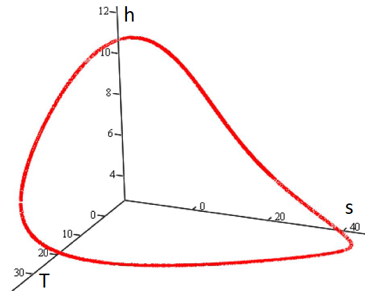

How can I plot 3-D diagram? So for example.
See please the SMath attach!

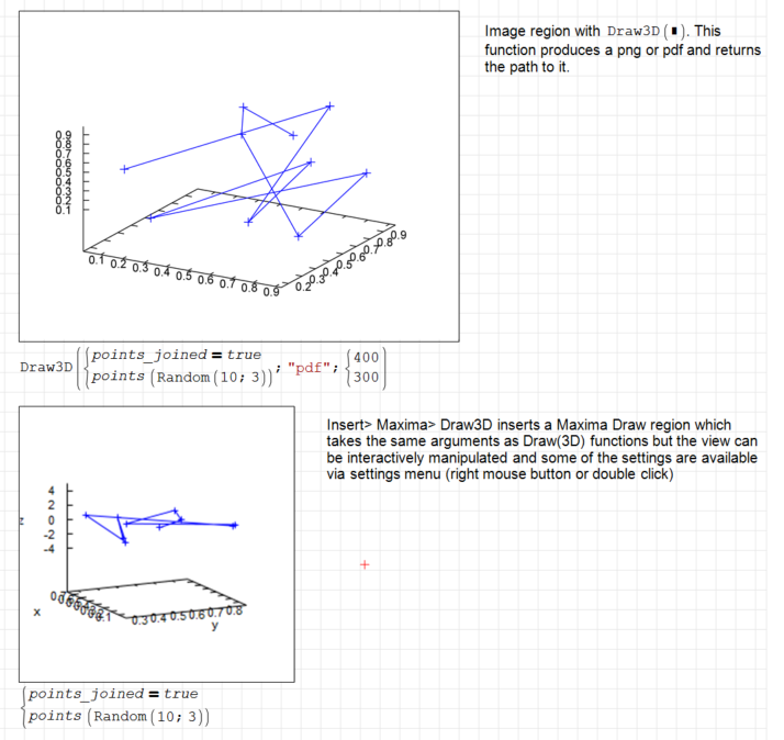

If the Maxima Plugin is an option for you, then just create a n x 3 data matrix and plot it using Draw3D. You find more plot examples in my Handbuch (section 8.1).

In response to this Thread...I have a question.. I modified points-joined=false and it works, but how can I get Points instead of little crosses?
