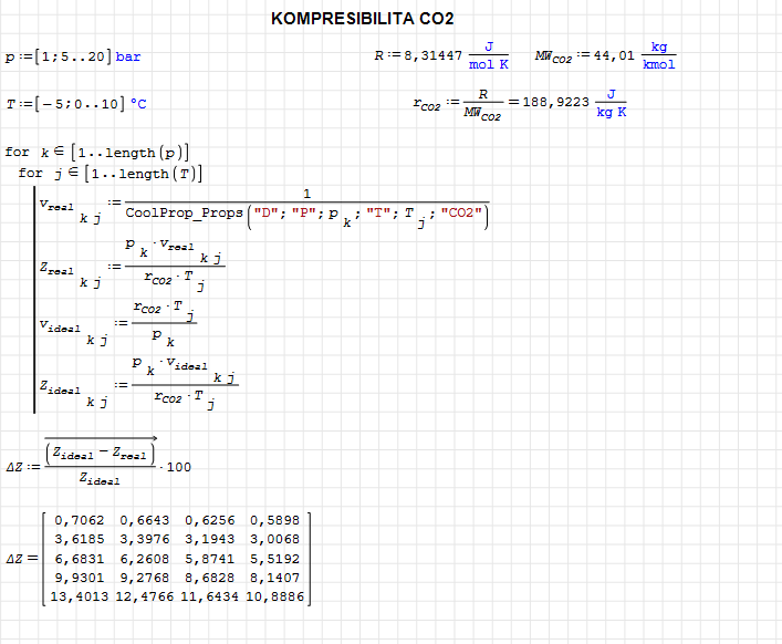

i would like to create 3d plot of compresibility with p and T as axis. How can i do that?
Thanks,
Tomáš

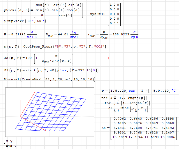

#2 Опубликовано: 14.12.2025 01:40:46
Hi. This is a way.
Z-CO2.sm (16,56 КиБ) скачан 705 раз(а).
Отредактировано 14.12.2025 05:15:11

#6 Опубликовано: 17.12.2025 22:17:20
The plots can be rotated with the mouse, yet there is a considerable time lag.
3d.sm (219,19 КиБ) скачан 678 раз(а).
Отредактировано 17.12.2025 22:18:37
