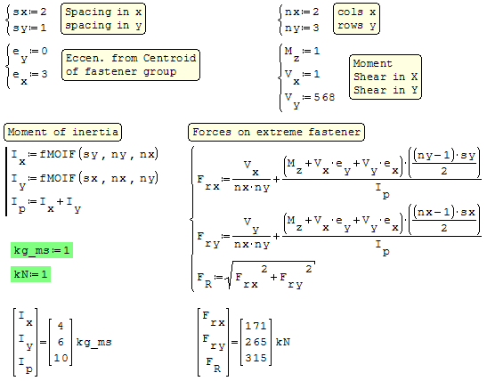

Since updating to Version 0.99.6671 (07 April 2018)
Several functions now return a "Cannot Calculate" error.
Any thoughts?
Thanks in advance!
Analysis - Fastener Group Elastic Vector Method.sm (20,57 КиБ) скачан 949 раз(а).

seems the problem is in matrix(0;#) (probably related with this), not sure if intentional or not.
Clear(r#) does the job BTW.

Hello.
Just remove first line from fMOIF(s#,n1#,n2#) definition:
r#:matrix(0,n1#)
Why it was added? It does nothing for further calculation. What is a reason for it?

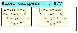

what is the best way to build up a matrix that starts with nothing?
Matrix/vector don't start with nothing, they self-build from some sort of applied calculations.
If the algorithm is a recursive composition, it may be true that it needs an initial something.
A good such example is Mandelbrot [in Samples, partially solved].
On the other hand, many, very many visitors depose the problem with too little or insuuficient
indications to help track their route to failure.
Utilities Matrix Sequence[N].sm (20,26 КиБ) скачан 694 раз(а).
Image Spot Dalmatian.sm (18,76 КиБ) скачан 889 раз(а).
