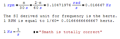

Wrote1 rpm = 1 rev/min = 1/60 rev/sec
And it is exactly how it is defined in SMath
![2016-09-07 19_03_15-SMath Studio Desktop - [rpm.sm].png](/ru-RU/files/Download/25qTPH/2016-09-07-19_03_15-SMath-Studio-Desktop---[rpm.sm].png)
But 1 revolution is equal to 360° (2pi)
![2016-09-07 19_03_26-SMath Studio Desktop - [rpm.sm].png](/ru-RU/files/Download/ds4DBc/2016-09-07-19_03_26-SMath-Studio-Desktop---[rpm.sm].png)
If you don't need relationships with the angles (the 2pi factor), simply redefine rpm
![2016-09-07 19_07_17-SMath Studio Desktop - [rpm.sm_].png](/ru-RU/files/Download/TnRTEb/2016-09-07-19_07_17-SMath-Studio-Desktop---[rpm.sm_].png)

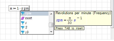

By the way, even sMath Studio (once you hover over the unit) displays it as a frequency (not angular velocity).
Good point indeed. This should be changed. It also applies to some other units. This can be seen best in the insert unit dialog. There, some categories are missing:
