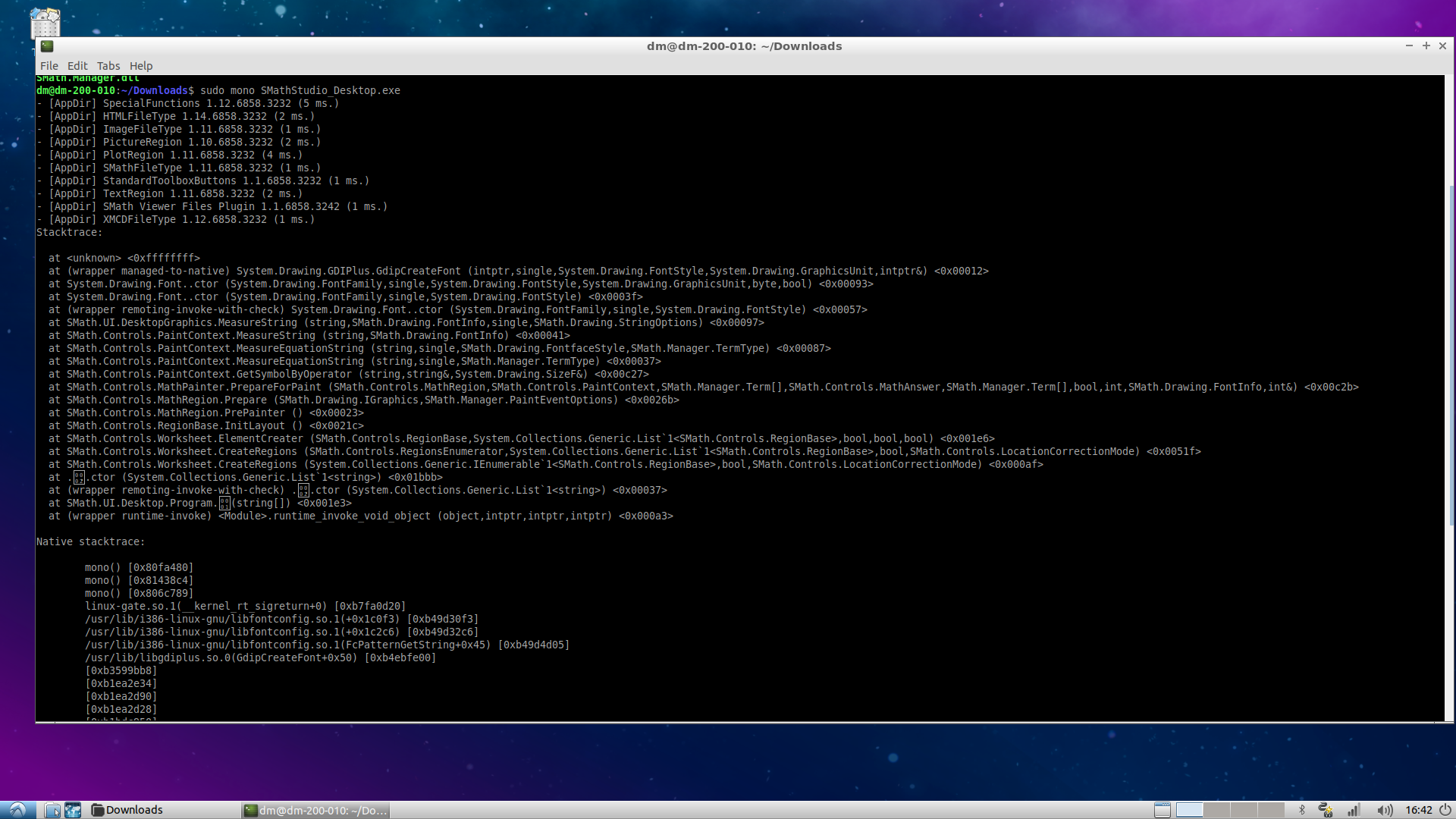

I can reproduce something similar in Linux Mint, it's the same issue?
mono SMathStudio_Desktop.exe
- [AppDir] SpecialFunctions 1.12.6839.38235 (9 ms.)
- [AppDir] HTMLFileType 1.14.6839.38235 (3 ms.)
- [AppDir] ImageFileType 1.11.6839.38235 (0 ms.)
- [AppDir] PictureRegion 1.10.6839.38235 (1 ms.)
- [AppDir] PlotRegion 1.11.6839.38235 (9 ms.)
- [AppDir] SMathFileType 1.11.6839.38235 (0 ms.)
- [AppDir] StandardToolboxButtons 1.1.6839.38235 (0 ms.)
- [AppDir] TextRegion 1.11.6839.38235 (0 ms.)
- [AppDir] SMath Viewer Files Plugin 1.1.6839.38249 (0 ms.)
- [AppDir] XMCDFileType 1.12.6839.38235 (1 ms.)
Stacktrace:
  at <unknown> <0xffffffff>
  at (wrapper managed-to-native) System.Drawing.GDIPlus.GdipCreateFont (intptr,single,System.Drawing.FontStyle,System.Drawing.GraphicsUnit,intptr& <0xffffffff>
  at System.Drawing.Font..ctor (System.Drawing.FontFamily,single,System.Drawing.FontStyle,System.Drawing.GraphicsUnit,byte,bool) <0x000af>
  at System.Drawing.Font..ctor (System.Drawing.FontFamily,single,System.Drawing.FontStyle) <0x00047>
  at (wrapper remoting-invoke-with-check) System.Drawing.Font..ctor (System.Drawing.FontFamily,single,System.Drawing.FontStyle) <0xffffffff>
  at SMath.UI.DesktopGraphics.MeasureString (string,SMath.Drawing.FontInfo,single,SMath.Drawing.StringOptions) <0x000cf>
  at SMath.Controls.PaintContext.MeasureString (string,SMath.Drawing.FontInfo) <0x0004f>
  at SMath.Controls.PaintContext.MeasureEquationString (string,single,SMath.Drawing.FontfaceStyle,SMath.Manager.TermType) <0x00097>
  at SMath.Controls.PaintContext.MeasureEquationString (string,single,SMath.Manager.TermType) <0x0003f>
  at SMath.Controls.PaintContext.GetSymbolByOperator (string,string&,System.Drawing.SizeF& <0x00f5f>
  at SMath.Controls.MathPainter.PrepareForPaint (SMath.Controls.MathRegion,SMath.Controls.PaintContext,SMath.Manager.Term[],SMath.Controls.MathAnswer,SMath.Manager.Term[],bool,int,SMath.Drawing.FontInfo,int& <0x00c9f>
  at SMath.Controls.MathRegion.Prepare (SMath.Drawing.IGraphics,SMath.Manager.PaintEventOptions) <0x002d7>
  at SMath.Controls.MathRegion.PrePainter () <0x00017>
  at SMath.Controls.RegionBase.InitLayout () <0x002a9>
  at SMath.Controls.Worksheet.ElementCreater (SMath.Controls.RegionBase,bool,bool,bool) <0x0027d>
  at SMath.Controls.Worksheet.CreateRegions (System.Collections.Generic.IEnumerable`1<SMath.Controls.RegionBase>,bool,SMath.Controls.LocationCorrectionMode) <0x0064f>
  at ...ctor (System.Collections.Generic.List`1<string> <0x01e4b>
  at (wrapper remoting-invoke-with-check) ...ctor (System.Collections.Generic.List`1<string> <0xffffffff>
  at SMath.UI.Desktop.Program. (string[]) <0x0024b>
  at (wrapper runtime-invoke) <Module>.runtime_invoke_void_object (object,intptr,intptr,intptr) <0xffffffff>
Native stacktrace:
	mono() [0x4b73d8]
	mono() [0x50f13b]
	mono() [0x423d22]
	/lib/x86_64-linux-gnu/libpthread.so.0(+0x10330) [0x7fa34a779330]
	/usr/lib/x86_64-linux-gnu/libfontconfig.so.1(+0x1b2ed) [0x7fa34552f2ed]
	/usr/lib/x86_64-linux-gnu/libfontconfig.so.1(+0x1ba29) [0x7fa34552fa29]
	/usr/lib/x86_64-linux-gnu/libfontconfig.so.1(+0x1c798) [0x7fa345530798]
	/usr/lib/x86_64-linux-gnu/libfontconfig.so.1(+0x1c980) [0x7fa345530980]
	/usr/lib/libgdiplus.so.0(GdipCreateFont+0x62) [0x7fa346b562c2]
	[0x415b2943]

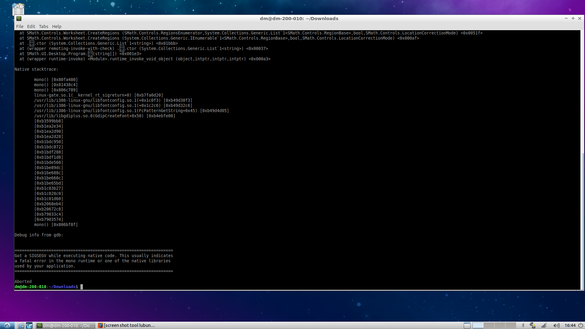

Hello [userlink]Eric Myers[/userlink],
Thank you for reporting the bug
The stack trace would be really useful
Yes.
In my struggles to get it up and running since my original post, I installed some fonts. I see that my error messages have now changed to the same as what you get:
(cli:32108): Gtk-WARNING **: 08:04:17.818: Unable to locate theme engine in module_path: "adwaita",
(cli:32108): Gtk-WARNING **: 08:04:17.824: Unable to locate theme engine in module_path: "adwaita",
- [AppDir] SpecialFunctions 1.12.6839.38235 (4 ms.)
- [AppDir] HTMLFileType 1.14.6839.38235 (1 ms.)
- [AppDir] PlotRegion 1.11.6839.38235 (4 ms.)
- [AppDir] XMCDFileType 1.12.6839.38235 (0 ms.)
Stacktrace:
  at (wrapper managed-to-native) System.Drawing.GDIPlus.GdipCreateFont (intptr,single,System.Drawing.FontStyle,System.Drawing.GraphicsUnit,intptr& <0x00087>
  at System.Drawing.Font..ctor (System.Drawing.FontFamily,single,System.Drawing.FontStyle,System.Drawing.GraphicsUnit,byte,bool) <0x000b7>
  at (wrapper remoting-invoke-with-check) System.Drawing.Font..ctor (System.Drawing.FontFamily,single,System.Drawing.FontStyle) <0x0007b>
  at SMath.UI.DesktopGraphics.MeasureString (string,SMath.Drawing.FontInfo,single,SMath.Drawing.StringOptions) <0x000d7>
  at SMath.Controls.PaintContext.MeasureString (string,SMath.Drawing.FontInfo) <0x00056>
  at SMath.Controls.PaintContext.MeasureEquationString (string,single,SMath.Drawing.FontfaceStyle,SMath.Manager.TermType) <0x000a7>
  at SMath.Controls.PaintContext.GetSymbolByOperator (string,string&,System.Drawing.SizeF& <0x01103>
  at SMath.Controls.MathPainter.PrepareForPaint (SMath.Controls.MathRegion,SMath.Controls.PaintContext,SMath.Manager.Term[],SMath.Controls.MathAnswer,SMath.Manager.Term[],bool,int,SMath.Drawing.FontInfo,int& <0x00dcb>
  at SMath.Controls.MathRegion.Prepare (SMath.Drawing.IGraphics,SMath.Manager.PaintEventOptions) <0x002fb>
  at SMath.Controls.MathRegion.PrePainter () <0x00013>
  at SMath.Controls.RegionBase.InitLayout () <0x002b9>
  at SMath.Controls.Worksheet.ElementCreater (SMath.Controls.RegionBase,bool,bool,bool) <0x002a9>
  at SMath.Controls.Worksheet.CreateRegions (System.Collections.Generic.IEnumerable`1<SMath.Controls.RegionBase>,bool,SMath.Controls.LocationCorrectionMode) <0x006a7>
  at ...ctor (System.Collections.Generic.List`1<string> <0x0208b>
  at (wrapper remoting-invoke-with-check) ...ctor (System.Collections.Generic.List`1<string> <0x00043>
  at SMath.UI.Desktop.Program. (string[]) <0x0026b>
  at (wrapper runtime-invoke) <Module>.runtime_invoke_void_object (object,intptr,intptr,intptr) <0x000d1>
Native stacktrace:
        /usr/bin/cli(+0xc8514) [0x55af89ff9514]
        /usr/bin/cli(+0x1217ce) [0x55af8a0527ce]
        /usr/bin/cli(+0x3d7e3) [0x55af89f6e7e3]
        /lib/x86_64-linux-gnu/libpthread.so.0(+0x12890) [0x7fe735f52890]
        /usr/lib/x86_64-linux-gnu/libfontconfig.so.1(+0x1ceed) [0x7fe7300ebeed]
        /usr/lib/x86_64-linux-gnu/libfontconfig.so.1(+0x1d092) [0x7fe7300ec092]
        /usr/lib/x86_64-linux-gnu/libfontconfig.so.1(FcPatternGetString+0x44) [0x7fe7300ed844]
        /usr/lib/libgdiplus.so.0(GdipCreateFont+0x59) [0x7fe73176e2d9]
        [0x41c3dd78]
Debug info from gdb:
[New LWP 32110]
[New LWP 32111]
[New LWP 32114]
[Thread debugging using libthread_db enabled]
Using host libthread_db library "/lib/x86_64-linux-gnu/libthread_db.so.1".
0x00007fe735f5223a in __waitpid (pid=32117, stat_loc=0x7fe7369ff27c, options=0) at ../sysdeps/unix/sysv/linux/waitpid.c:30
30      ../sysdeps/unix/sysv/linux/waitpid.c: No such file or directory.
  Id   Target Id         Frame
* 1    Thread 0x7fe736ae1780 (LWP 32108) "Main" 0x00007fe735f5223a in __waitpid (pid=32117, stat_loc=0x7fe7369ff27c, options=0) at ../sysdeps/unix/sysv/linux/waitpid.c:30
  2    Thread 0x7fe734fff700 (LWP 32110) "SGen worker" 0x00007fe735f4d9f3 in futex_wait_cancelable (private=<optimized out>, expected=0, futex_word=0x55af8a4eca08) at ../sysdeps/unix/sysv/linux/futex-internal.h:88
  3    Thread 0x7fe735658700 (LWP 32111) "Finalizer" 0x00007fe735f506d6 in futex_abstimed_wait_cancelable (private=0, abstime=0x0, expected=0, futex_word=0x55af8a4dd640) at ../sysdeps/unix/sysv/linux/futex-internal.h:205
  4    Thread 0x7fe725f20700 (LWP 32114) "Main" 0x00007fe735a4bbf9 in __GI___poll (fds=0x7fe7350b5440, nfds=2, timeout=15) at ../sysdeps/unix/sysv/linux/poll.c:29

Got a SIGSEGV while executing native code. This usually indicates
a fatal error in the mono runtime or one of the native libraries
used by your application.
Aborted

dmmartinez
dmmartinez
Just installed Lubuntu 18 LTS on an HP Stream mini and wanted to install SMath (0_99_68658). Installed mono and double clicked the .exe and is tries to load, then nothing. Tried in terminal in mono. Got a set of errors about missing font library. Tried again to do a scree capture and had a slightly different error. Attached screenshots. Also said: debug info from gdb:
Показать спойлер
