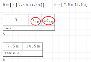

Hello !
I have this display problem when trying to pass
a matrix to a Table.
Table_Region_Problem.sm (11,47 КиБ) скачан 1564 раз(а).

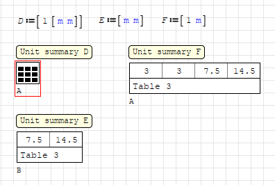

#2 Опубликовано: 27.08.2023 09:11:12
Unit summary doesn't work as it should either.
Maybe these are bugs. Regards

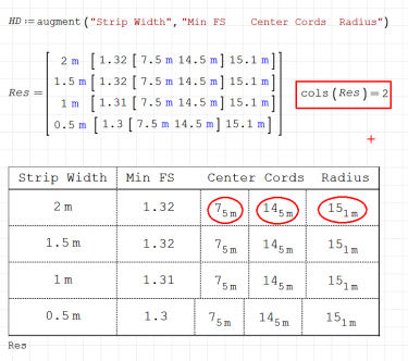

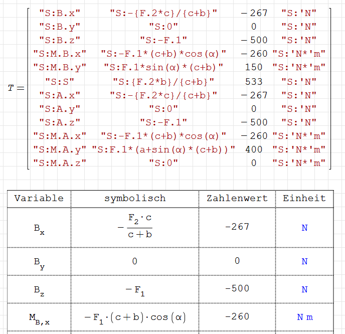

#4 Опубликовано: 28.08.2023 04:31:21
In the attached sheet I tried to automatically compile a results summary. Note that there is a single entry point for unit specification in the algorithm (no chance for mismatch between displayed unit and unit used to calculate the numerical values.
1-3.sm (137,75 КиБ) скачан 1551 раз(а).
#5 Опубликовано: 28.08.2023 07:53:00
My post #1 is a simple example to show the Table Region problem.
At post #3 construct the matrix as independent cols, thus compatible Table.
Next, nest the two pertinent cols to explicit your Engineering c/w header.
