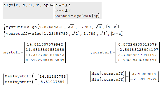

Hello Community,
I have following topic
- I have a Calculation with some ± operators and therefore I use usual figures (not a Matrix).
- This calculation creats more than one results.
- Now it is my gaol to find out which results are the max and min.
- The challange is that the standard max. and min. operator do not work with standard figures.
See an example:
Thanks for some Ideas how I can solve this challenge.

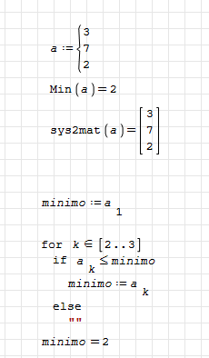

The "Min" and "Max" functions are used with the "Custom Function" Plugin.
Please note that the "sys2mat" functions are provided in the same plugin to transform systems into matrices.
If you don't want to use plugins, you can still as shown in the example
unfortunately "system" is not read by the "lenght" function so it is not possible (without the use of plugins) to create a function to automate the search for the minimum independent of the length of the system

Utilities Algo(r,s,u,v,op).sm (6,84 КиБ) скачан 1248 раз(а).

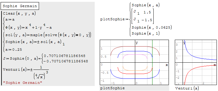

... you can plot as well many functions of this ± style.
#6 Опубликовано: 02.03.2020 15:52:27
...cooking plates for Sophie ... Venturi for Jean.
