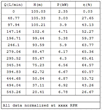

However, what I would like to do is something like this below:
I would like to show a variable value in place of "xxxx" in the caption of the above table.
I have not found any way to do that and probably it is not possible, for the actual version of this plug-in.

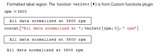

You could just place a formatted label region over the caption . This is a bit weird but it works. Use the context menu to switch off input and border.
label.sm (4,57 КиБ) скачан 1249 раз(а).
In newer SMath versions, you can also use a standard text region with an embedded formula, where you can suppress input display and even specify a unit.
