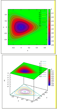

Vibrations of a triangular membrane
Calculation formulas are taken from thearticle:
http://ivdon.ru/uploads/article/pdf/IVD_44__1_Chernyshov.pdf_30f490557a.pdf
Vibration triangular membrane.sm (319,69 КиБ) скачан 1290 раз(а).

Thanks, works fine after doctoring CreateMesh.
Vibrations of a triangular membrane(Maxima)
TriangularMembrane Maxima.sm (279,28 КиБ) скачан 1399 раз(а).
