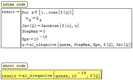

Fragments withal_nleqsolve() can be reduced to one line.
alnlegsolve(3).sm (635,89 КиБ) скачан 1577 раз(а).
NDTM Amarasekera 14.04.2022 10:06:00
#3 Опубликовано: 14.04.2022 10:03:58
NDTM Amarasekera
NDTM Amarasekera
Hello,ndtma
Fragments withal_nleqsolve()can be reduced to one line.
Hello Ber7,
Thank you very much for your very valuable suggestion.
It works fine.

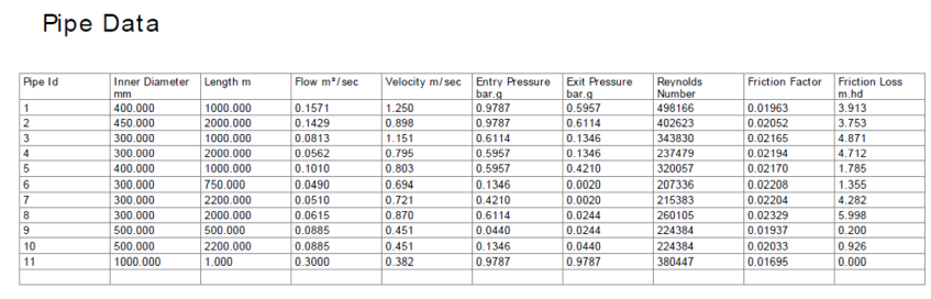

Hello ndtmda
Here are the results of your example calculated
with a very old version of Pipe Flow Expert.

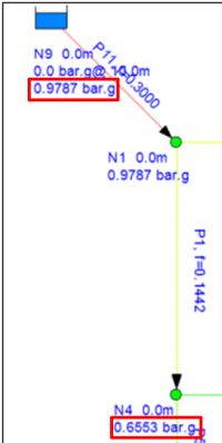

Can you please explain how the marked values of gauge pressures are calculated?
Thank you.
#13 Опубликовано: 06.06.2022 23:31:51
CBG
CBG
Hello Ndtma
Hello Carlos
Thank you.
This pressure (0.9787 bar g) is caused by the water level in the tank, which is 10 meters.
The pressure of 0.6553 bar g is obtained by subtracting from the inlet pressure
of 0.9787 bar g. the losses in the pipe of 0.3234 bar g (3.304 m hd)
The system is not correctly resolved for the pressures, since nodes 3 and 8 have
pressures below atmospheric.
NDTM Amarasekera 07.06.2022 22:55:00

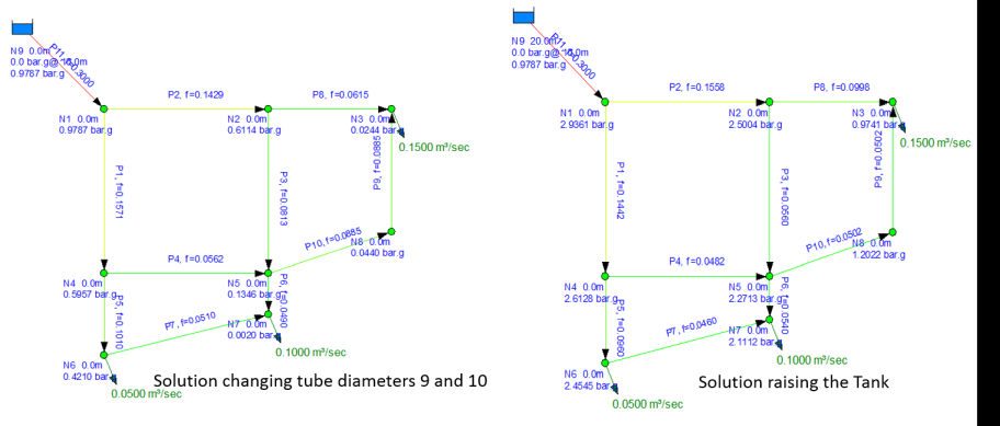

Changing the diameter of tubes 9 and 10 from 0.25 m diameter to 0.5 m, the problem of negative pressures is solved.
Another way to solve it is by increasing the level below the tank from 0m to 20m. and with the liquid level at 10 m
#16 Опубликовано: 07.06.2022 22:55:01
NDTM Amarasekera
NDTM Amarasekera
You're welcome.
Thank you Carlos. Your contributions are very much appreciated.

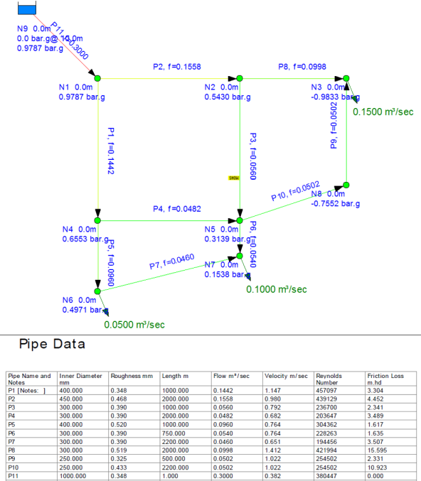

Hello Carlos,
Can you please post the Pipe Data Table (with Pipe Number, Inner diameter, ..... Re, Friction Head loss)
for the case Changing the diameter of tubes 9 and 10 from 0.25 m diameter to 0.5 m..
as I get different results for this case.
Hope I am not troubling you.
#18 Опубликовано: 11.06.2022 16:19:34
CBG
CBG
Hello Ndtma
Hello Carlos,
There is no problem.
Here is the requested table
Davide Carpi 12.06.2022 09:04:00
