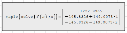

#4 Опубликовано: 06.07.2022 18:49:02
I have an polynomial equation ... which I want to get the roots for.
Your polynomial is doctored in yellow.
By inspection, the plot reveals complex roots, i.e: 2 complex roots.

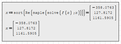

Here is your complete answer by the way.
Good old maple saves the day again.

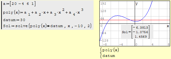

#7 Опубликовано: 07.07.2022 08:38:23
... once your cubic in hand,
you can solve for a specific datum.
Cheers ... Jean.
