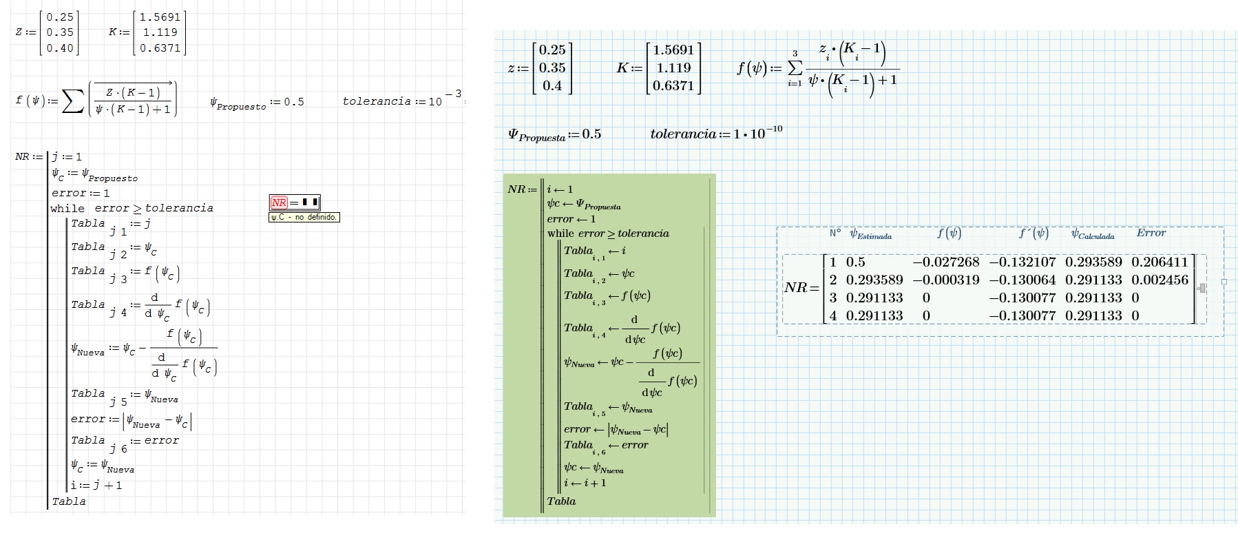

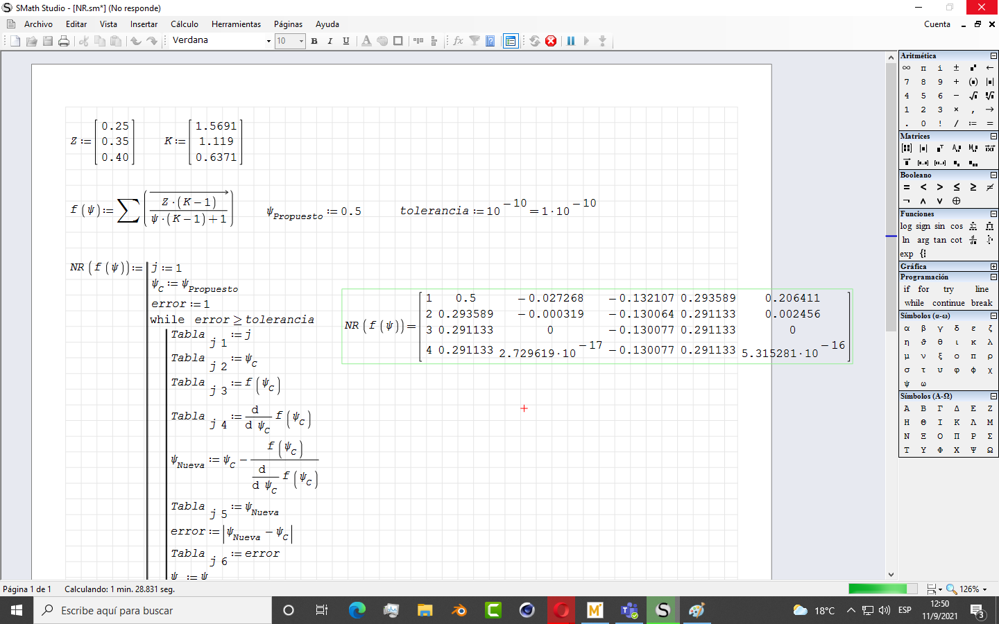

How can I do this loop while?
what am I doing wrong?
NR.sm (8,06 КиБ) скачан 1186 раз(а).

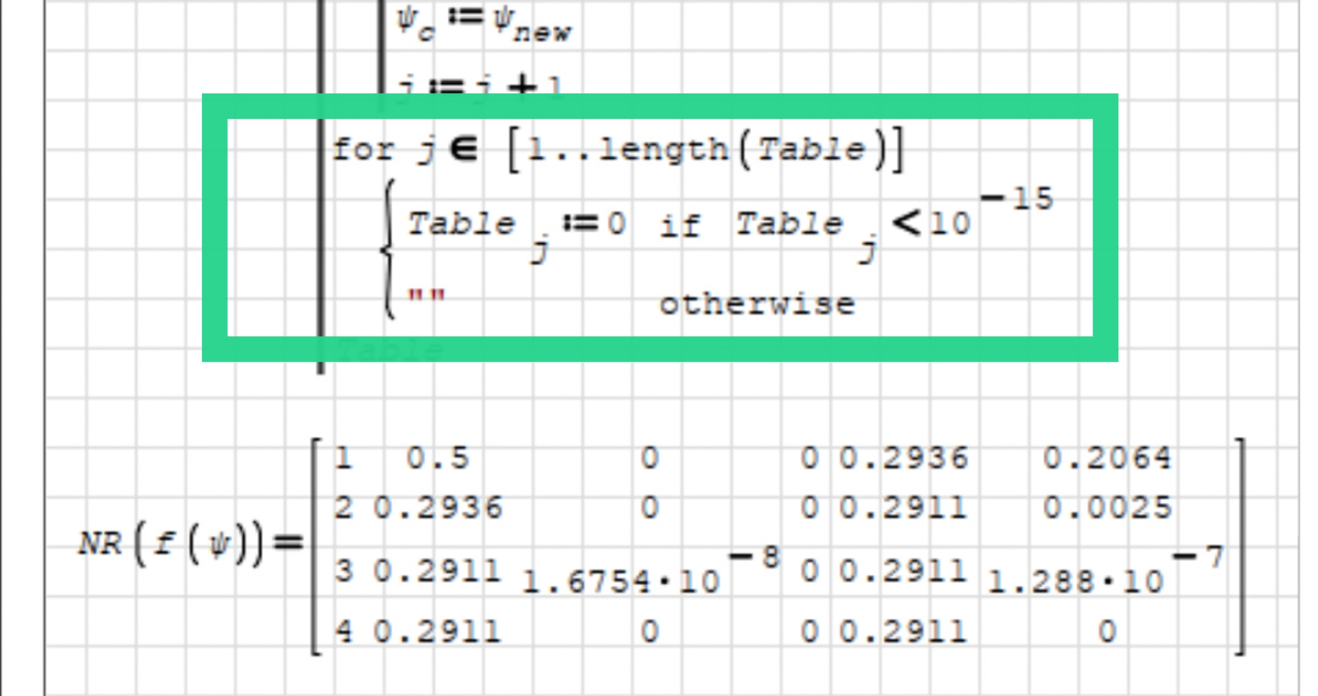

I think it already came out, but how do I make the numbers that are almost 0 not appear as 2.72 * 10 ^ -17?
#3 Опубликовано: 11.09.2021 15:23:39
Add a check for every element if they are lower than something.
And if they are, make them zero.

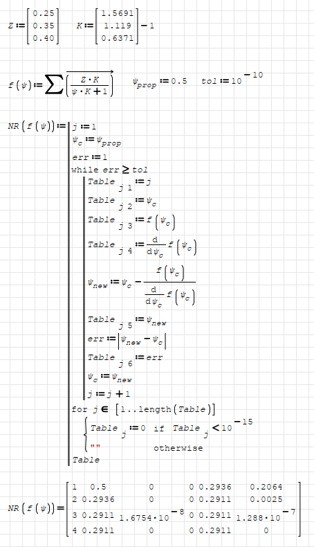

what function does this have?
Thank you so much

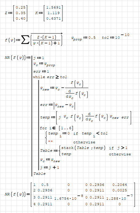

#5 Опубликовано: 11.09.2021 16:09:46
That is cases(), it is in Custom Functions plugin.
I would prefer to write your algorithm like attached.
It is just my preference by the way.
