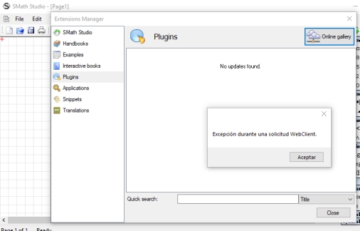

Hi. I have this error in SMath version 0.99.7251.32800, in a windows 10 on a x86 processor:
SMath starts, but can't update any plugin.
I try to search webclient in the forum without success.
Any help is welcome.
Thanks in advance.

Hi Martin, thanks. It seems that it's a problem in my windows, but it's the only software with this error, and all help that I found about it is always about some programming error and nothing in the side of the users.

Hi Davide. Tanks.
Yes, I can access to the page.
I also check my firewall (Windows firewall by default) and my av (free Panda cloud) and don't see restrictions about SMath or something like webclient procedures.
Also the preconfigured portable version can't access to the updates, so obviously the problem is in my windows system, but can't find nothing useful in the web about this error.
