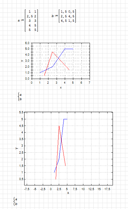

How to find the intersection of two matrices. Sorry if I said wrong. An example is attached, a graph is built in it. The graph shows that there are two intersections. How do I find the intersection coordinates.
I have such a task. I need to get the third matrix, which begins as matrix (a), and after the intersection is constructed as matrix ( b ). Maybe someone knows the finished function. The matrices that we use in the problem always have two columns and a different number of rows. In the form of a matrix, we digitize graphs so that we can work with them.

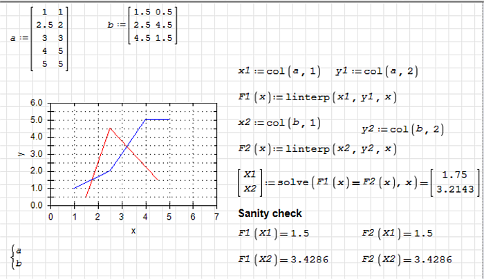

The linterp does your digitizing project.

ndtma, Here I also expected such decision. When I saw him I really liked him. But for some reason, he didn’t want to work with my matrices.(
Jean Giraud, Sorry, I did not understand your calculation. The calculation is very complicated and at the end does not show the result
WrotePompelmoTell,This is just a great calculation. I never thought that finding intersection points was such a difficult task. I was preparing for something simple. Thank you so much, for I came up with my own method, which is many times simpler and only suits my types of graphs, when the construction goes from top to bottom, from left to right.
ndtma, Here I also expected such decision. When I saw him I really liked him. But for some reason, he didnât want to work with my matrices.(
1. NDTMA is OK for what you gave. You didn't give any matrix.
