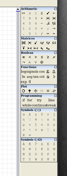

Hello. There is the following problem in SMathStudioDesktop.0_99_7030.Mono under linux.
Not all characters are displayed in the sidebar.
Показать спойлер
The panel itself works fine. I think the characters are missing in the font.
Question. What font is used there? Can it be changed via configuration files?
Or what font should be added to the system to be used in this place?

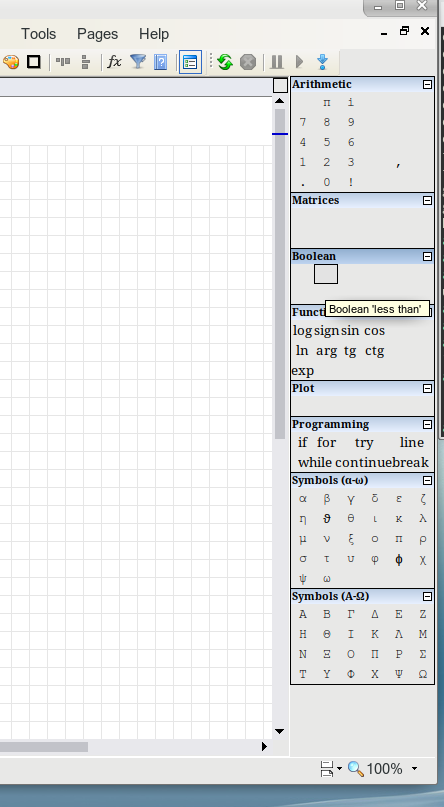

I have the same problem on Ubuntu 64bits 16.04 ( and 18.04). I suppose that the release of mono has disturbed the display. Before, Smath works fine.
My version: Mono JIT compiler version 6.4.0.198

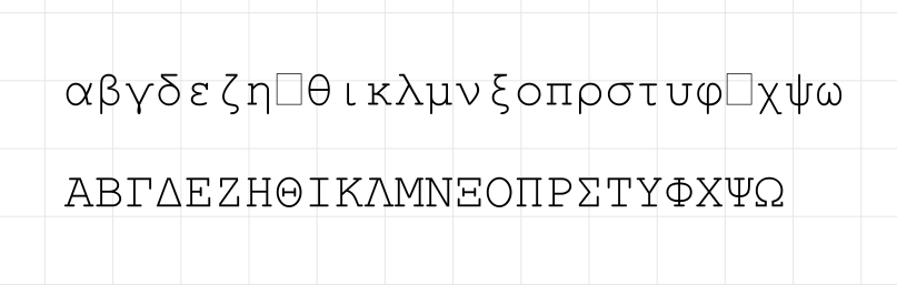

Similar but not same situation over here. Arch Linux latest with SMath 0.99.7219.
Almost all displayed except the two lowercase latin characters.
Much more important issue is these two are not displayed in regions. Shown as a rectangular instead.

You mean lower case Greek ... because they don't exist !!!
