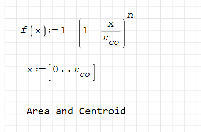

How to find area and centroid
question_20230711.sm (2,88 КиБ) скачан 1293 раз(а).

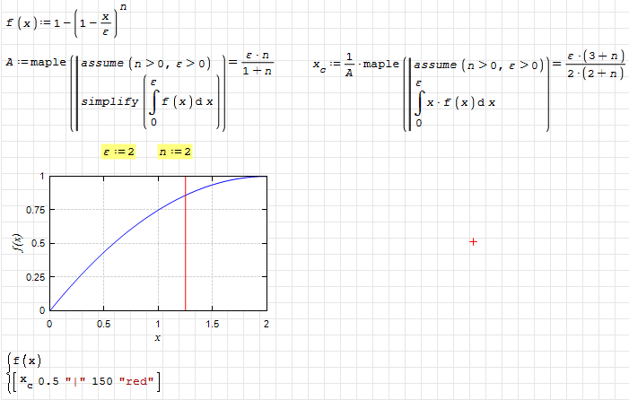

#2 Опубликовано: 11.07.2023 04:59:38
Ac.sm (6,17 КиБ) скачан 1254 раз(а).

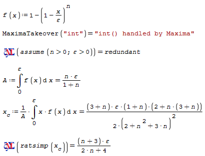

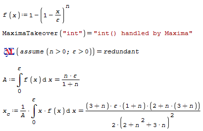

#6 Опубликовано: 11.07.2023 09:40:34
Maxima is a bit lazy with simplification...
Ac.sm (7,08 КиБ) скачан 1247 раз(а).

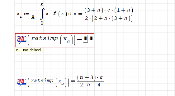

why can't i do right that?
what's the problem?
