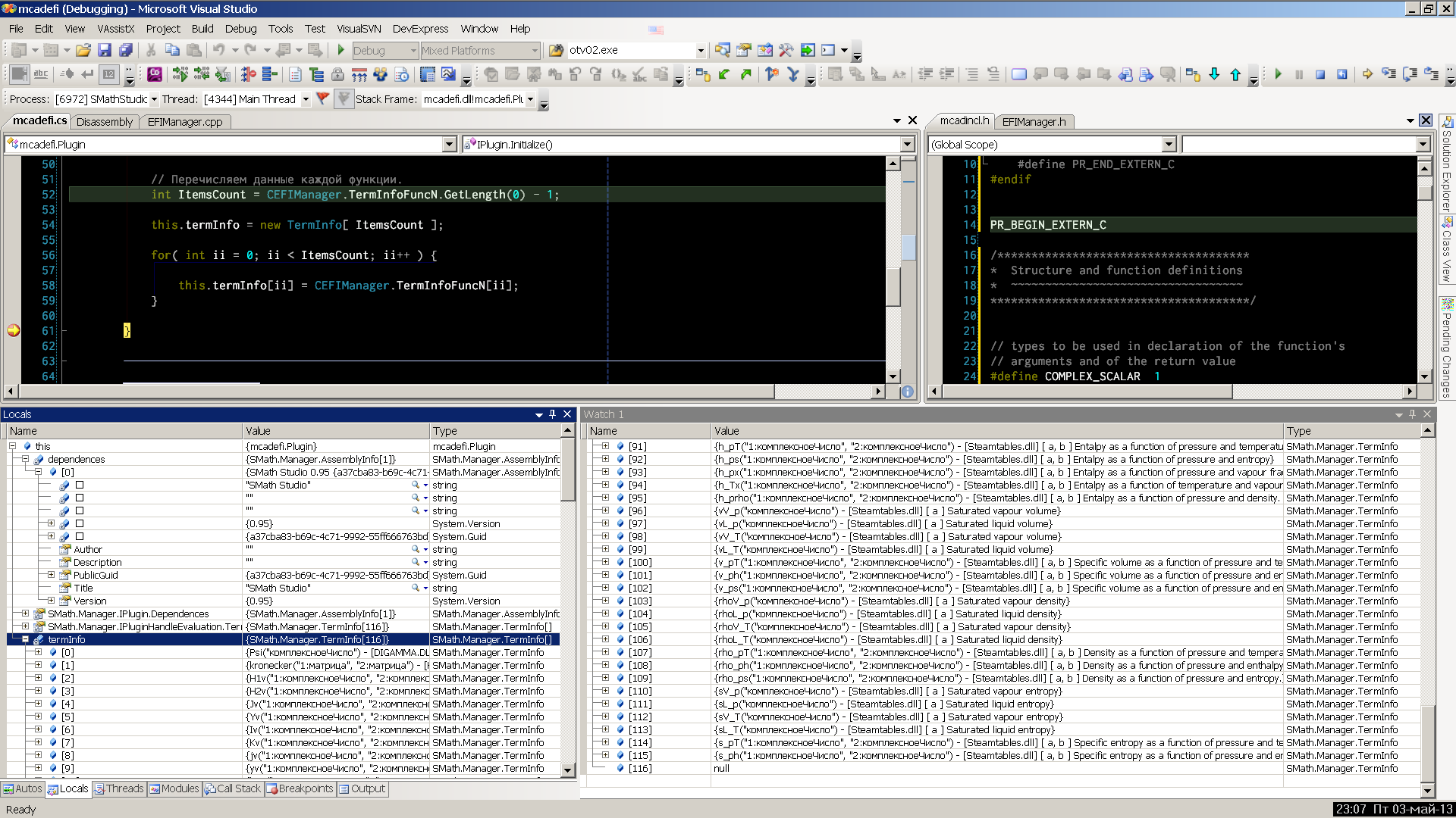

In the plug-ins dialog box, if I choose "EFI for SMath Studio" and plugin consists of more than one hundred functions, their output will take a long time. For example, for 116 functions that will be about 20 seconds.
I looked at the work of the method IPlugin.Initialize() and from my side everything seems to be fine (Mathcad EFI plugin).
