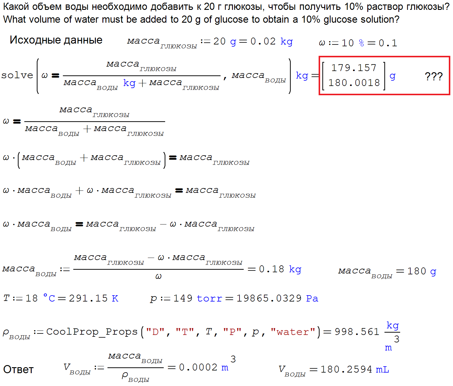

#1 Опубликовано: 20.10.2023 16:53:00
Valery Ochkov
Valery Ochkov
Glucose.sm (11,67 КиБ) скачан 1441 раз(а).

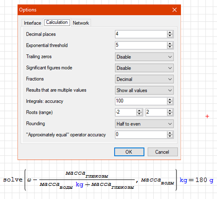

#2 Опубликовано: 21.10.2023 02:16:30
Solve is a numerical procedure. Like all numerical methods, it has the usual issues. Reducing the search interval increases accuracy, returning only one solution. Notice that in the picture the actual interval is from -2000 grams to +2000 grams.

#3 Опубликовано: 21.10.2023 02:25:18
Valery Ochkov
Valery Ochkov
My solution
