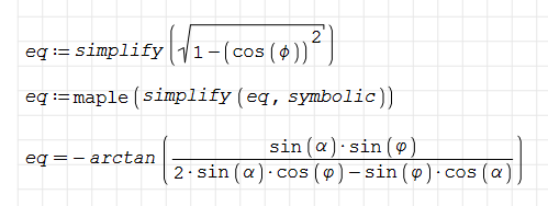

is this solution correct?
is this solution correct? - Сообщения
question_230609.sm (3,75 КиБ) скачан 1117 раз(а).

Obviously not, but the bug isn't that obvious: just avoid to use that 'phi' (j Ctrl-G):

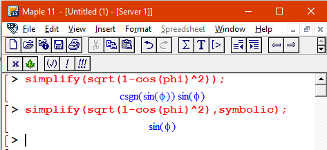

597 сообщений из 1 377 понравились пользователям.
Is it only valid for Windows?
Linux mono doesn't have this problem.

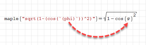

Yes, these are different letters:
cos(ϕ) and cos(φ)
maple() works with φ
This was done to unambiguously convert variables into Greek letters:
maple() function uses implicit encoding of Greek letters:
churichuro 09.06.2023 15:32:00

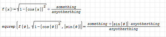

I think the result soomoon expects is this, but it requires a newer version of maple:
#7 Опубликовано: 12.06.2023 01:58:17
where can i get a new version of maple ?
#8 Опубликовано: 12.06.2023 11:12:20
1 107 сообщений из 1 786 понравились пользователям.
Inside SMath, you can't. This is a workaround, valid for real values
