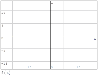

When I right click on the graph and try to animate, I get "t not defined."
test.sm (3 КиБ) скачан 1490 раз(а).
#2 Опубликовано: 10.07.2023 15:54:27
When I try to animate, I get "t not defined."
SS 6179 is more convivial:
"plot then define animation variable"
Click over the plot then set the animation, variable.

I right click on the graph and then select animate t.
I select 2 frames per second.
Still get error, t not defined.

Don't name your animation step as t.
Actually, it is better not to name plot variables as x,y,t.
