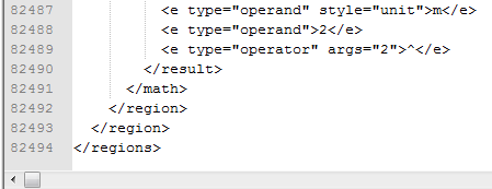

Trying to reopen a file that I wrote and that refused to be closed normaly, I receive this message:
"Unexpected end of file occured.
The following elements are not closed:
result, math, region, regions. Line 82490, position 12."
I posted the file here:
file
Is it possible to recover the file ? If yes, how ?
Thanks a lot for any help,
Ioan

The problem might be solved by just closing the xml tags in the file, but I can't try...
If that is the solution than I guess that SMath should be able to propose this approach and apply the fix.
The solution is indicated by mkraska and the result is in the attached file

Thanks for your answers,
Many thanks to w3b5urf3r for the recovered file.
Now the original file is attached to my first post.

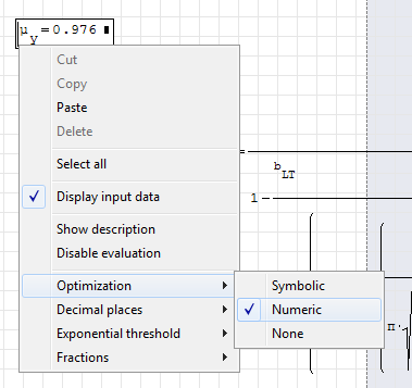

all results are in fractional mode, against my temptatives of changing.
simply change the result optimization from "none" to "numeric"
regards,
w3b5urf3r
